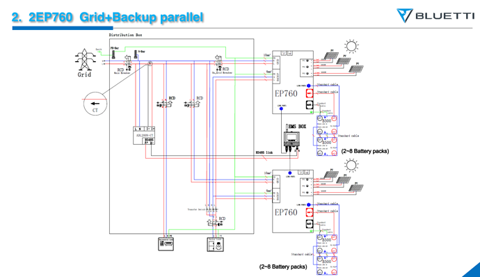

Bluetti Application Scenarios presentation from 2024 includes a parallel scenario. It shows both EP760 Link Port1 connected to EMS Box (probably same EMS box used for EP900) and then EMS is connected to ADL200N-CT (Meter & CT). Up to 8 x B500 batteries (39.68kwH). However, EP760 installation manual does not mention parallel operation. I am not sure if Bluetti officially support this or if it was just an early idea. Hopefully @BLUETTI_CARE can confirm ? Back in 2024 a single EP760 supported maximum 4 x B500. Now in 2026, at least in Australia, a single EP760 can support 8 x B500 which may mean parallel mode is not needed ?

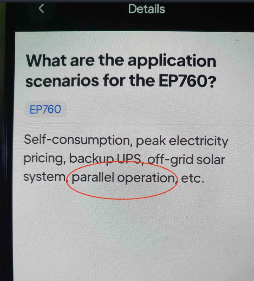

@BLUETTI_CARE If not supported you should update the FAQ found inside Bluetti App to remove “parallel operation”.
@dmc In that context I would personally take it to mean parallel operation at the same time as the grid (i.e. that you can supply house loads from the grid and the battery simultaneously), not that two units can parallel together; and given the response from Bluetti I’m guessing that’s how they intended it too.
Edit: but you’re right, it’s not really clear enough.
Sourcing power from grid at same time as battery is a basic function of most home batteries, for example AC passthru once battery SOC falls blow SOC Low value. I would not expect any special scenario for grid+battery. I think from the slides Bluetti were advertising two EP760 in parallel mode, but why they say it is now unsupported is a mystery ? Did they find a bug or issue that cannot be resolved ? I would hope @BLUETTI_CARE has answer to clarify.
Sorry I overlooked your slide above! Maybe its only available in less strict jurisdictions where they don’t care about backfeeding the grid in a grid down situation… but then again, support seems to be good at saying “not possible” when they’ve just misunderstood the question… or else the marketing material was generated by someone who didn’t actually know the limitations of specific products, which sadly seems to be common with older Bluetti units.
